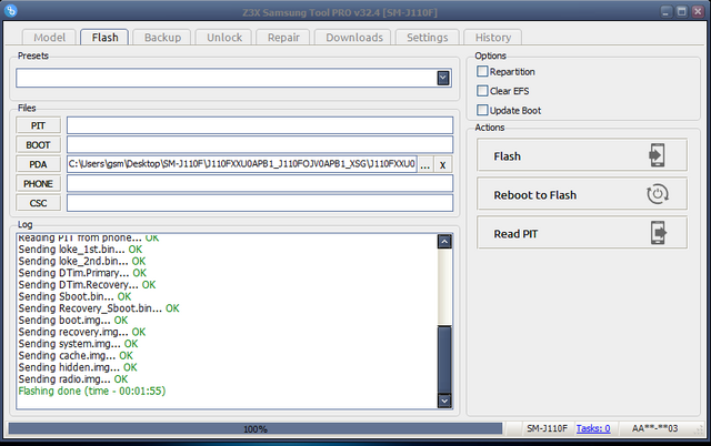

Samsung SM-J110F Baseband Unknown imei null 100000% Successfully
Operation: Flash
Selected model: SM-J110F
Software version: 32.4
File analysis... OK
Total file size: 0x400B94B0 (1024 Mb)
Searching USB Flash interface... COM7 detected
Setup connection... OK
Reading PIT from phone... OK
Sending loke_1st.bin... OK
Sending loke_2nd.bin... OK
Sending DTim.Primary... OK
Sending DTim.Recovery... OK
Sending Sboot.bin... OK
Sending Recovery_Sboot.bin... OK
Sending boot.img... OK
Sending recovery.img... OK
Sending system.img... OK
Sending cache.img... OK
Sending hidden.img... OK
Sending radio.img... OK
Flashing done (time - 00:01:55)
Done with Samsung Tool PRO v.32.4
J110FXXU0APB1_J110FOJV0APB1_XSG
WORKED LYK CHARM 100%
Operation: Flash
Software version: 29.5
File analysis OK
Total file size 0x400B94B0 (1024 Mb)
Searching USB Flash interface COM4 detected
Setup connection OK
Reading PIT from phone OK
Sending loke_1st.bin OK
Sending loke_2nd.bin OK
Sending DTim.Primary OK
Sending DTim.Recovery OK
Sending Sboot.bin OK
Sending Recovery_Sboot.bin OK
Sending boot.img OK
Sending recovery.img OK
Sending system.img OK
Sending cache.img OK
Sending hidden.img OK
Sending radio.img OK
Flashing done (time - 00:01:54)
After reboot imei & baseband available
