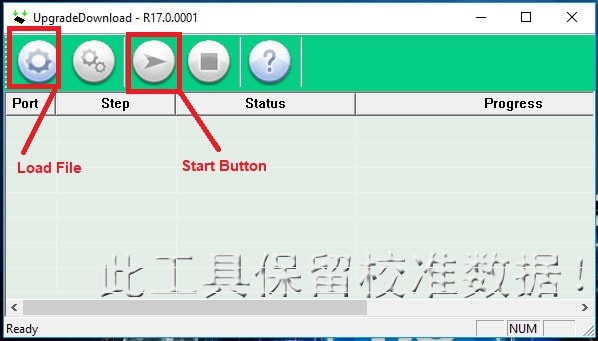

- Download Jio LYF F61F stock ROM or Flash file from above download section. [Size 250MB]
- Extract the downloaded Jio LYF F61F flash file on desktop. [Getting any issue to download firmware, please notify us]
- Download Jio LYF F61F firmware flash tool on pc and run “UpgradeDownload.exe” file as administrator.
- Click on Gear Icon [Load Packets] from tool and browse LYF-F61F-01-10-140917.pac file from firmware folder. [Firmware must be in .PAC Format]
- Hit on “START” button to start Jio LYF F61F stock ROM flashing process.
- Next, press & Hold centre Key [OK Button] and attach USB cable at the same time.
- USB driver installation will be start on pc and will take few minutes to install properly.
- Once the drivers installed, flashing process will start and you will see the complete process bar in tool’s status bar.
- End of the successful flashing, you can see “Success” message on the tool.
- Unplug the device from pc and setup the device again.
- All done!!!
