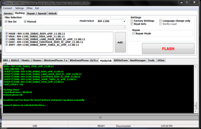

nokia 150 rm-1190 contact service problem fix solve
Verify files ...
MAUI : RM-1190_DUBAI_ROM_eMP_11.00.11
VIVA : RM-1190_DUBAI_VIVA_eMP_11.00.11
LANG : RM-1190_DUBAI_LANG_PACK_ROM_IC_eMP_11.00.11
CUST : RM-1190_DUBAI_CUSTPACK_ROM_IC_eMP_11.00.11
JMPT : RM-1190_DUBAI_JUMP_TABLE_IC_eMP_11.00.11
- > MODE : FullFlash
Dead Mode is Selected
Waiting for USB device...
1. Phone should be Off!
2. Battery must be charged and inserted! ( if not used external power )
- > If phone can't switch to BL - use battery or flash from Local mode!
--- Insert USB cable now! ---
Wait for phone...
Phone found! [ 10 ]
Sync...
Sync Ok, read regs...
Inital regs read done
Boot Info :
BB_CPU_ID : 6261
BB_CPU_HW : CB01
BB_CPU_SW : 0001
BB_CPU_SB : 8000
BB_CPU_NM : [MediaTek] MT6261_S0001
BB_CPU_SN : E8EC4D52ED2EA2064EBC31549F367E10
BROM Protocol Version : 05
BROM Status : 0000
Comm Status : 0000
EXBL Status : Alive [ USB Load Active ]
Switch to BL done
BL Version : 01
Setting...
Setting done , result code 0x8000
Project ID : DUBAI61D.11.00.11.p1
BROM/BL stage done
Seek and prepare DownloadAgent
DownloadAgent matching HW Found!
DA verify and select done
Sending DA to target ...
DA_eMP_Dubai.fg
DA_VERIFY : 00
DA_JUMP   : 00100000
DA_AUTH   : Passed!
DA_INFO   : 0xC0 , Ver : 3.2 , BBID : 0x8E
DA_CSTAT  : 0x5A
SOC_VERIFY : 0xC1
BOOT_STYLE : SF_FLASH_BOOT
NOR Flash IC initialized
[0] : FLASH_VEN : 0x0113 ,
[0] : FLASH_DIE : 00EF 0070 0016 0000
[0] : FLASH_LEN : 0x00400000
FAT_RANGE : 0x003A0000-0x003F7FFF , LEN : 0x00058000
SecureDecrypt : RM-1190_DUBAI_ROM_eMP_11.00.11
SecureDecrypt : RM-1190_DUBAI_VIVA_eMP_11.00.11
SecureDecrypt : RM-1190_DUBAI_LANG_PACK_ROM_IC_eMP_11.00.11
SecureDecrypt : RM-1190_DUBAI_CUSTPACK_ROM_IC_eMP_11.00.11
SecureDecrypt : RM-1190_DUBAI_JUMP_TABLE_IC_eMP_11.00.11
OVRLP : 000069B900000001
PHPID : DUBAI61D.11.00.11.p1
OVRLP : 00004DF900000001
DA : FORMAT_BIN
Processing Flash Pre-format
FILES : 5
SAFE_BLOCK : 04
FORMAT_BIN : Ok
WRITE_STYLE : DEF : 0x01 (SEQ)
Write : RM-1190_DUBAI_ROM_eMP_11.00.11
Write : RM-1190_DUBAI_LANG_PACK_ROM_IC_eMP_11.00.11
Write : RM-1190_DUBAI_CUSTPACK_ROM_IC_eMP_11.00.11
Write : RM-1190_DUBAI_JUMP_TABLE_IC_eMP_11.00.11
Write : RM-1190_DUBAI_VIVA_eMP_11.00.11
CODE_DNLOAD : Ok
[VERIFY] DONE : RM-1190_DUBAI_ROM_eMP_11.00.11
[VERIFY] DONE : RM-1190_DUBAI_LANG_PACK_ROM_IC_eMP_11.00.11
[VERIFY] DONE : RM-1190_DUBAI_CUSTPACK_ROM_IC_eMP_11.00.11
[VERIFY] DONE : RM-1190_DUBAI_JUMP_TABLE_IC_eMP_11.00.11
[VERIFY] DONE : RM-1190_DUBAI_VIVA_eMP_11.00.11
CODE_VERIFY : Ok
Flashing done!
Total flash time : 00:00:56
Reboot phone Ok
