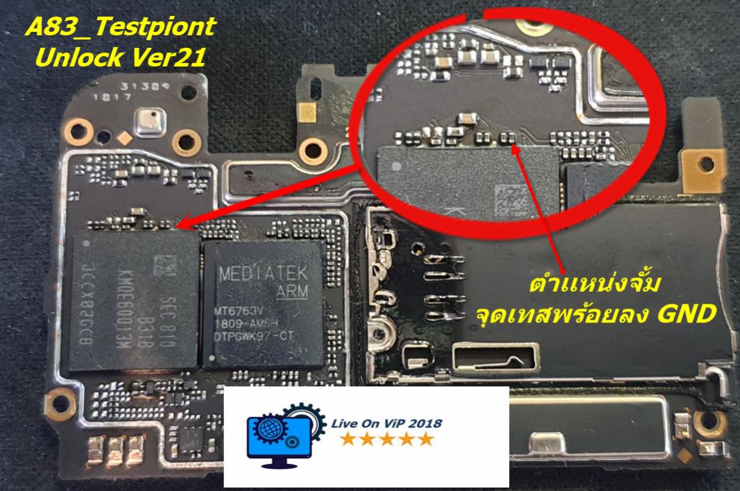

Definition Applied
1. Power Off Phone , Remove Battery, Insert Battery Back
2. Insert USB cable. In some cases Required Hold BootKey
3. Use Miracle Boot Key In cases Boot key not Find
4. Battery Should be Charged more then 50%
Waiting for USB Port...
Set MediaTek USB Port_V1632 (COM7)
Connecting to Phone,Wait..
Connected to Phone.
CPU: MT6763 SW:0001 Ver: CA01
Downloading Boot8 ...
EMMC Size: 0x0747C00000
Flash Type: EMMC
INT/EXT RAM Size: 0x40000/0xC0000000
Reading infr(EMMC)...
version:7.1.1
manufacturer:OPPO
model:OPPO A83js
brand:OPPO
Done.
Definition Applied
Definition Applied
you can Set Formatting Addr
Connected to Phone.
Flash Type: EMMC
Formatting Nand Flash...
Format Satrt Addr??0x5A88000, Size: 0x100000
Format Satrt Addr??0x170801000, Size: 0x2000000
>>Format nand OK(Android Need to wait a few minutes the phone is switched)
