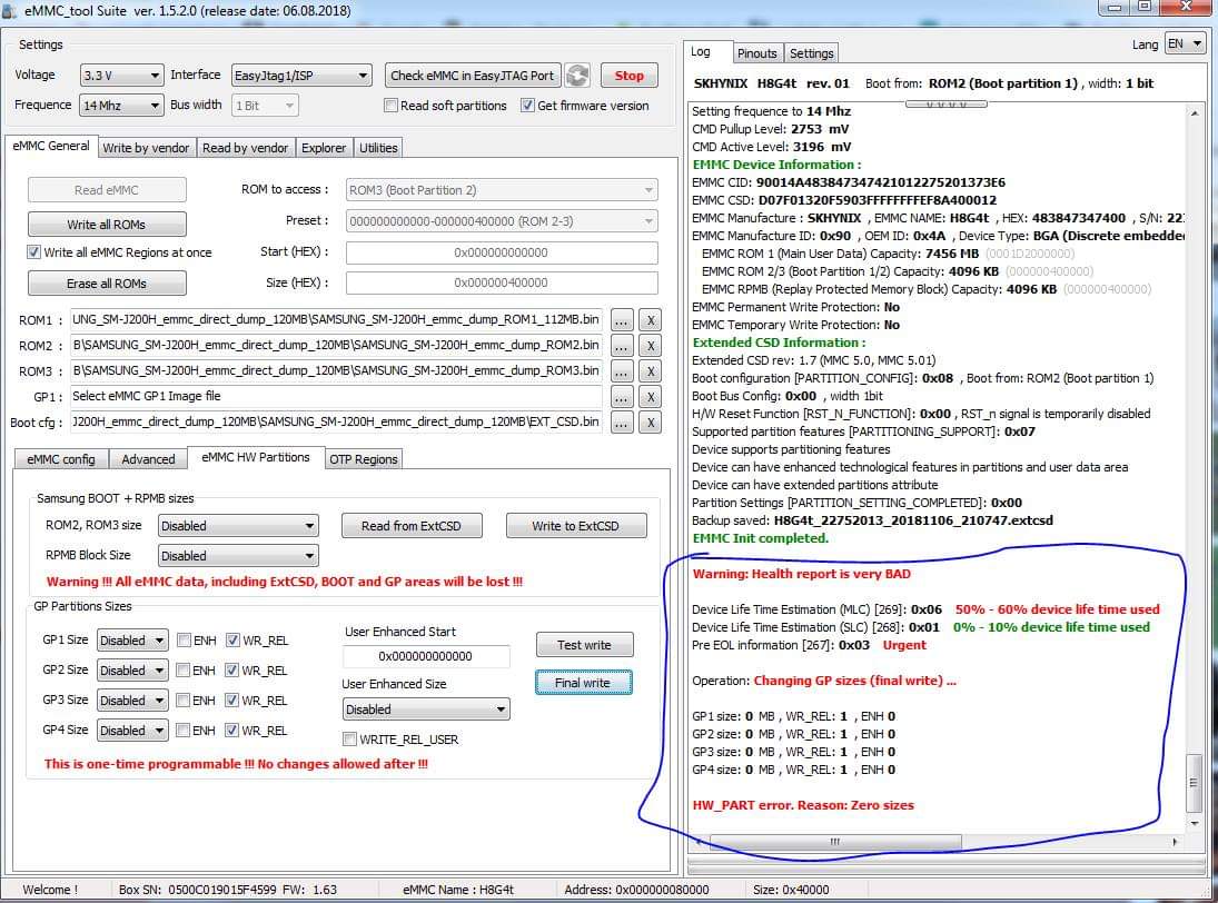

hi easy team
some one can help me to solve this problm on samsung j200h
Warning: Health report is very BAD
im traying many time but same error
Changelog:
06.08.2018 (ver 1520)
Fix: Bugs that have been found through your crash report
Fix: Writing ROM2 for Samsung (Write by vendor)
Fix: Freezing the program on a RandomVerify
Add: Folder for saving to Explorer (in settings)
Add: Extract from storevol from emmc (explorer)
Add: Automatic repair of damaged storevol when extracting (Explorer)
Add: Adding MountPoints for partitions (efs, userdata) when formatting
Add: Checking for an empty EFS before backup (Read by Vendor Samsung)
Setting frequence to 14 Mhz
CMD Pullup Level: 2361 mV
CMD Active Level: 2743 mV
EMMC Device Information :
EMMC CID: 90014A483847347421012275201373E6
EMMC CSD: D07F01320F5903FFFFFFFFEF8A400012
EMMC Manufacture : SKHYNIX , EMMC NAME: H8G4t , HEX: 483847347400 , S/N: 22752013 , rev. 0x01
EMMC Manufacture ID: 0x90 , OEM ID: 0x4A , Device Type: BGA (Discrete embedded) , Date: 7/2016
EMMC ROM 1 (Main User Data) Capacity: 7456 MB (0001D2000000)
EMMC ROM 2/3 (Boot Partition 1/2) Capacity: 4096 KB (000000400000)
EMMC RPMB (Replay Protected Memory Block) Capacity: 4096 KB (000000400000)
EMMC Permanent Write Protection: No
EMMC Temporary Write Protection: No
Extended CSD Information :
Extended CSD rev: 1.7 (MMC 5.0, MMC 5.01)
Boot configuration [PARTITION_CONFIG]: 0x08 , Boot from: ROM2 (Boot partition 1)
Boot Bus Config: 0x00 , width 1bit
H/W Reset Function [RST_N_FUNCTION]: 0x00, RST_n signal is temporarily disabled
Supported partition features [PARTITIONING_SUPPORT]: 0x07
Device supports partitioning features
Device can have enhanced technological features in partitions and user data area
Device can have extended partitions attribute
Partition Settings [PARTITION_SETTING_COMPLETED]: 0x00
Backup saved: H8G4t_22752013_20181107_112607extcsd
EMMC Init completed.
Device Life Time Estimation (MLC) [269]: 0x06 50% - 60% device life time used
Device Life Time Estimation (SLC) [268]: 0x01 0% - 10% device life time used
Pre EOL information [267]: 0x03 Urgent
Get firmware version
Firmware info not found
Changelog:
