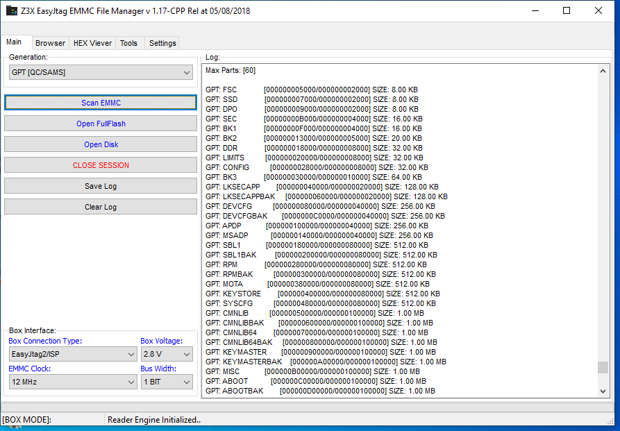

Check BootConfig for the selected vendor
All done   time: [01:34:48:888]
Setting interface to EasyJtag2/ISP
Setting bus width to 1 Bit
Setting frequence to 12 MHz
CMD Pullup Level: 2072 mV
CMD Active Level: 2714 mV
EMMC Device Information :
EMMC CID: 90014A68423861503E010FD884CC7593
EMMC CSD: D02700328F5903FFFFFFFFEF8E400043
EMMC Manufacture : SKHYNIX , EMMC NAME: hB8aP> , HEX: 68423861503E , S/N: 0FD884CC , rev. 0x01
EMMC Manufacture ID: 0x90 , OEM ID: 0x4A , Device Type: BGA (Discrete embedded) , Date: 7/2018
   EMMC ROM 1 (Main User Data) Capacity: 29816 MB (000747800000)
   EMMC ROM 2/3 (Boot Partition 1/2) Capacity: 4096 KB (000000400000)
   EMMC RPMB (Replay Protected Memory Block) Capacity: 16384 KB (000001000000) Counter: 33 , Response: Not Clean
EMMC Permanent Write Protection: No
EMMC Temporary Write Protection: No
Extended CSD Information :
Extended CSD rev: 1.8 (MMC 5.1)
Boot configuration [PARTITION_CONFIG]: 0x00 , Boot from: no boot
Boot Bus Config: 0x00 , width 1bit
H/W Reset Function [RST_N_FUNCTION]: 0x01, RST_n signal is permanently enabled
Supported partition features [PARTITIONING_SUPPORT]: 0x07
Device supports partitioning features
Device can have enhanced technological features in partitions and user data area
Device can have extended partitions attribute
Partition Settings [PARTITION_SETTING_COMPLETED]: 0x01
Backup saved: hB8aP__0FD884CC_20200113_203634.extcsd
EMMC Init completed.
Scanning soft partitions
GPT header is found and is valid
Partition: fsc, [000000005000 - 000000007000], size: 000000002000 (8.00 KB)
Partition: ssd, [000000007000 - 000000009000], size: 000000002000 (8.00 KB)
Partition: dpo, [000000009000 - 00000000B000], size: 000000002000 (8.00 KB)
Partition: sec, [00000000B000 - 00000000F000], size: 000000004000 (16.0 KB)
Partition: bk1, [00000000F000 - 000000013000], size: 000000004000 (16.0 KB)
Partition: bk2, [000000013000 - 000000018000], size: 000000005000 (20.0 KB)
Partition: DDR, [000000018000 - 000000020000], size: 000000008000 (32.0 KB)
Partition: limits, [000000020000 - 000000028000], size: 000000008000 (32.0 KB)
Partition: config, [000000028000 - 000000030000], size: 000000008000 (32.0 KB)
Partition: bk3, [000000030000 - 000000040000], size: 000000010000 (64.0 KB)
Partition: lksecapp, [000000040000 - 000000060000], size: 000000020000 (128. KB)
Partition: lksecappbak, [000000060000 - 000000080000], size: 000000020000 (128. KB)
Partition: devcfg, [000000080000 - 0000000C0000], size: 000000040000 (256. KB)
Partition: devcfgbak, [0000000C0000 - 000000100000], size: 000000040000 (256. KB)
Partition: apdp, [000000100000 - 000000140000], size: 000000040000 (256. KB)
Partition: msadp, [000000140000 - 000000180000], size: 000000040000 (256. KB)
Partition: sbl1, [000000180000 - 000000200000], size: 000000080000 (512. KB)
Partition: sbl1bak, [000000200000 - 000000280000], size: 000000080000 (512. KB)
Partition: rpm, [000000280000 - 000000300000], size: 000000080000 (512. KB)
Partition: rpmbak, [000000300000 - 000000380000], size: 000000080000 (512. KB)
Partition: mota, [000000380000 - 000000400000], size: 000000080000 (512. KB)
Partition: keystore, [000000400000 - 000000480000], size: 000000080000 (512. KB)
Partition: syscfg, [000000480000 - 000000500000], size: 000000080000 (512. KB)
Partition: cmnlib, [000000500000 - 000000600000], size: 000000100000 (1.00 MB)
Partition: cmnlibbak, [000000600000 - 000000700000], size: 000000100000 (1.00 MB)
Partition: cmnlib64, [000000700000 - 000000800000], size: 000000100000 (1.00 MB)
Partition: cmnlib64bak, [000000800000 - 000000900000], size: 000000100000 (1.00 MB)
Partition: keymaster, [000000900000 - 000000A00000], size: 000000100000 (1.00 MB)
Partition: keymasterbak, [000000A00000 - 000000B00000], size: 000000100000 (1.00 MB)
Partition: misc, [000000B00000 - 000000C00000], size: 000000100000 (1.00 MB)
Partition: aboot, [000000C00000 - 000000D00000], size: 000000100000 (1.00 MB)
Partition: abootbak, [000000D00000 - 000000E00000], size: 000000100000 (1.00 MB)
Partition: dip, [000000E00000 - 000000F00000], size: 000000100000 (1.00 MB)
Partition: bk4, [000000F00000 - 000001000000], size: 000000100000 (1.00 MB)
Partition: tz, [000001000000 - 000001200000], size: 000000200000 (2.00 MB)
Partition: tzbak, [000001200000 - 000001400000], size: 000000200000 (2.00 MB)
Partition: mcfg, [000001400000 - 000001800000], size: 000000400000 (4.00 MB)
Partition: devinfo, [000001800000 - 000002000000], size: 000000800000 (8.00 MB)
Partition: fsg, [000002000000 - 000002800000], size: 000000800000 (8.00 MB)
Partition: modemst1, [000002800000 - 000003000000], size: 000000800000 (8.00 MB)
Partition: modemst2, [000003000000 - 000003800000], size: 000000800000 (8.00 MB)
Partition: bk5, [000003800000 - 000004000000], size: 000000800000 (8.00 MB)
Partition: splash, [000004000000 - 000005000000], size: 000001000000 (16.0 MB)
Partition: dsp, [000005000000 - 000006000000], size: 000001000000 (16.0 MB)
Partition: mdtp, [000006000000 - 000008000000], size: 000002000000 (32.0 MB)
Partition: persist, [000008000000 - 00000A000000], size: 000002000000 (32.0 MB)
Partition: persistbak, [00000A000000 - 00000C000000], size: 000002000000 (32.0 MB)
Partition: boot, [00000C000000 - 000010000000], size: 000004000000 (64.0 MB)
Partition: recovery, [000010000000 - 000014000000], size: 000004000000 (64.0 MB)
Partition: logdump, [000014000000 - 000018000000], size: 000004000000 (64.0 MB)
Partition: modem, [000018000000 - 000020000000], size: 000008000000 (128. MB)
Partition: cache, [000020000000 - 000030000000], size: 000010000000 (256. MB)
Partition: oem, [000030000000 - 000040000000], size: 000010000000 (256. MB)
Partition: system, [000040000000 - 000100000000], size: 0000C0000000 (3.00 GB)
Partition: vendor, [000100000000 - 000140000000], size: 000040000000 (1.00 GB)
Partition: cust, [000140000000 - 000174000000], size: 000034000000 (832. MB)
Partition: userdata, [000174000000 - 0007477FBE00], size: 0005D37FBE00 (23.3 GB)
GPT header successfully parsed
Get firmware version
Brand = xiaomi
Manufacturer = Xiaomi
Device = sakura
Model = Redmi 6 Pro
CPU Abi = arm64-v8a
Android release = 8.1.0
Firmware version = ZQL1715-sakura-build-20190125223038
Miui Version = V10.2.2.0.ODICNXM
Firmware date = Fri Jan 25 22:30:11 CST 2019
