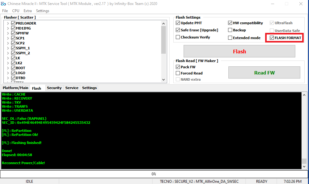

tecno spark 4 kc2 after flash dead 100% working
Starting flash helio.
[0] WRITE TO PARTITION [ preloader ]
[4] WRITE TO PARTITION [ md1img ]
[5] WRITE TO PARTITION [ spmfw ]
[6] WRITE TO PARTITION [ scp1 ]
[7] WRITE TO PARTITION [ scp2 ]
[8] WRITE TO PARTITION [ sspm_1 ]
[9] WRITE TO PARTITION [ sspm_2 ]
[13] WRITE TO PARTITION [ lk ]
[14] WRITE TO PARTITION [ lk2 ]
[15] WRITE TO PARTITION [ boot ]
[16] WRITE TO PARTITION [ logo ]
[17] WRITE TO PARTITION [ dtbo ]
[18] WRITE TO PARTITION [ tee1 ]
[19] WRITE TO PARTITION [ tee2 ]
[20] WRITE TO PARTITION [ vendor ]
[21] WRITE TO PARTITION [ system ]
[22] WRITE TO PARTITION [ vbmeta ]
[26] WRITE TO PARTITION [ cache ]
[27] WRITE TO PARTITION [ recovery ]
[28] WRITE TO PARTITION [ tkv ]
[35] WRITE TO PARTITION [ tranfs ]
[38] WRITE TO PARTITION [ userdata ]
HINT:
If phone stuck on logo, for some phones help factory reset.
Select factory reset tab/reset to factory default.
[helio]Wait untill phone will start charging.
[0]All done.
tecno spark 4 kc2 3/32gb
1. Make sure device is powered off. Power off, if need. Wait 20 seconds after
2. Insert USB cable in phone
Waiting for device connection ...
PTFN : MediaTek PreLoader USB VCOM (Android) (COM17)
MODE : PRELOADER PORT
PORT : 17
Waiting BOOT ack ...
PRELOADER : ACK confirmed!
BROM : Init BROM
BROM init passed!
CHIP : MT6761 , SBID : 0x8A00 , HWVR : 0xCA01 , SWVR : 0x0200
CODE : Merlot
TYPE : MODERN RAPHAEL
BROM : SecLevel : 0x00000005
BROM : SecMode : SBC+SDA
BROM : BROM|BL : 0xFF|0x03
BROM : PRELOADER PORT
MODE : TECNO : SECURE_v2 | Manual : Disabled
BROM : SOCID : C32843FFE8BAE183188E2A783C404D67F5AB3AAB7629059F790A3E68D8EB2A37
BROM : Change Configuration settings for target
AGENT : Look for suitable BootChain in DA ...
AGENT : MTK_AllInOne_DA_SWSEC.bin
AGENT : Found MT6761
AGENT : MTK_DOWNLOAD_AGENT
BROM : Sending 1st DA ...
BROM : DA sent
BROM :Transfer control to DA ...
DA : AGENT started!
DA : SYNC
DA : MODE : PRELOADER
DA : EXT_RAM initialized!
DA : BOOT to 2nd DA ...
DA : 2ND stage confirmed!
DA : SYNC with DA passed!
DA : Receiving HW info
SRAM: 0x00080000 [ 512.00 KB ]
DRAM: 0xC0000000 [ 3.00 GB ]
EMMC: 90014A68423861503E02EF0ECEAB5691
EMMC: VEN : HYNIX | OEM : 4A01 | DEV : hB8aP>
EMMC:
BOOT1 : 0x00400000 [ 4.00 MB ]
BOOT2 : 0x00400000 [ 4.00 MB ]
RPMB : 0x01000000 [ 16.00 MB ]
USER : 0x747C00000 [ 29.12 GB ]
CHIP : MT6761 , SBID : 0x8A00 , HWVR : 0xCA01 , SWVR : 0x0000 , EVOL : 0x0000
RNID : C15C91EDE439CC0E63EAF7D375F7AC4D
DA : USB : HIGH-SPEED
Boot done!
[FL] : HW verification passed!
SEC_DL : False (RAPHAEL)
SEC_ID : 0x494E46494E495459424F584245535432
[FL] : Pre-Erase
[FL] : Whole Flash Erase enabled!
Erase : 0x0000000000000000 : 0x0000000747C00000
[FL] : RePartition
[FL] : RePartition Ok!
[FL] : Flashing now ...
Write : PRELOADER
tecno spark 4 kc2 baseband unknown fix by cm2
KC2-H6113AI-P-191123V237
