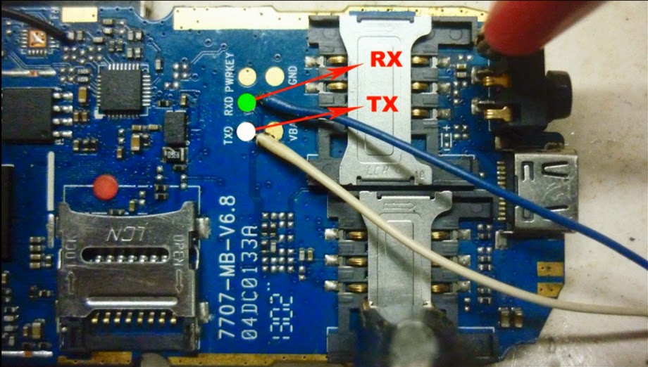

open phone find rx tx pinout on pcb solder it
(its feture phone pic andriod device also contain rxtx )
